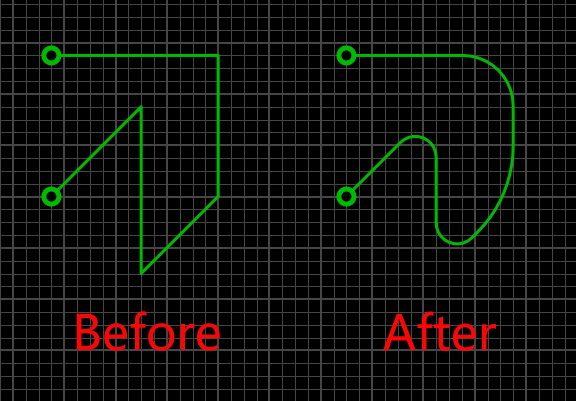

Sprint Layout are un plugin interesant, cam asa se pot desena traseele folosind pluginul respectiv, las si link spre descarcare: https://github.com/cdhigh/sprintFontRel ... _track.png
https://github.com/cdhigh/sprintFontRelease
