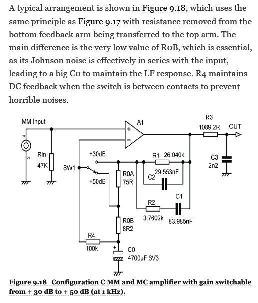

O lectura buna este "Small Signal Audio Design by Douglas Self".
Schema similaira celei postate de Victor:
